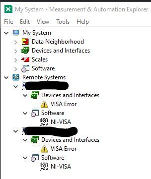

I can now see two other test PCs but I can't see their hardware.  Under Devices and Interfaces it shows a VISA Error.
 I'm still not sure if this simply can't be done with NI-MAX or I have a firewall/network/IT issue.  I will post back if I have any new info...
EDIT: I tried the "Troubleshoot Remote System Directory" function and it only had options for PXI/RIO systems so you may be right that this is only for real-time systems.  I'm sure that there are other ways to achieve the goal but I was really hoping the ability was just built-in to NI-MAX.  I will keep on looking for a solution.
