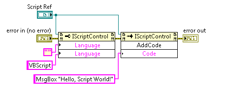

By the way, are you seeing this bug? If so, just do what the article says, and write a null string to the "Language" property and then set it to "VBScript". For example, the following little bit works:
Message Edited by smercurio_fc on 08-09-2006 12:49 PM
Message 5 of 13
(13,858 Views)
Yeah, thanks. I was actually wondering what to do with this bug
Thanks again

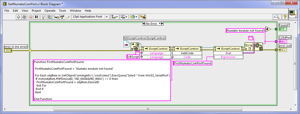

Maybe it to late but there is a code I used to execute a VB script
LabVIEW ChampionArchitect
Message 8 of 13

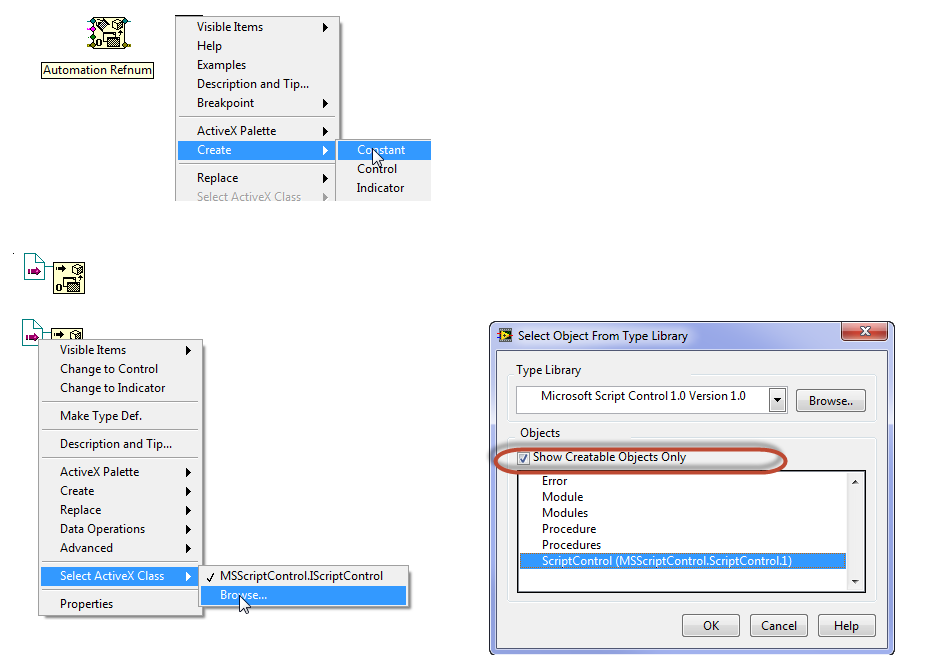

Where do you get the MSscriptControl and IScriptControl?
Message 9 of 13
(12,756 Views)
There is a couple of step to get the right automation Refnum:
Let me know if you need more explanation
