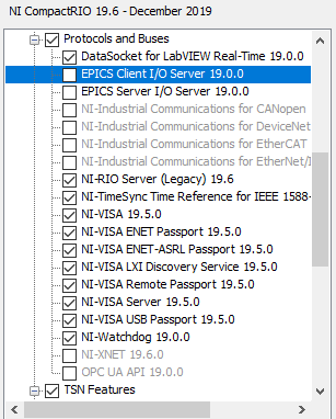

Hi Jens,
- install the software/driver package VISA with ENET support on the sbRIO
Your suggestion did help a bit since now I am not getting error while trying to establish a connection or while sending data but receiving data is not working.
Below is what all drivers I have installed on the sbRIO:
