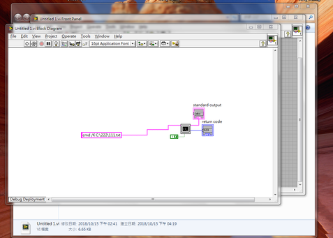

Use the system exec.vi to invoke the DOS command
Use the system exec.vi to invoke the DOS command. It is normal to use the source program, but when EXE is delayed by 8S, the CMD window will be popped up.

Try the command string in a cmd window and you'll see it doesn't work. Just Calling on a .txt will have no effect. If you want it to open in text editor you can e.g. use "start filename.txt"

The source program is achievable.I mainly want to study why the source program and exe are different, which is very important to me.
