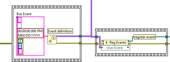

Creation of event:

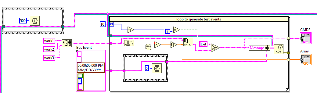

Firing off events:

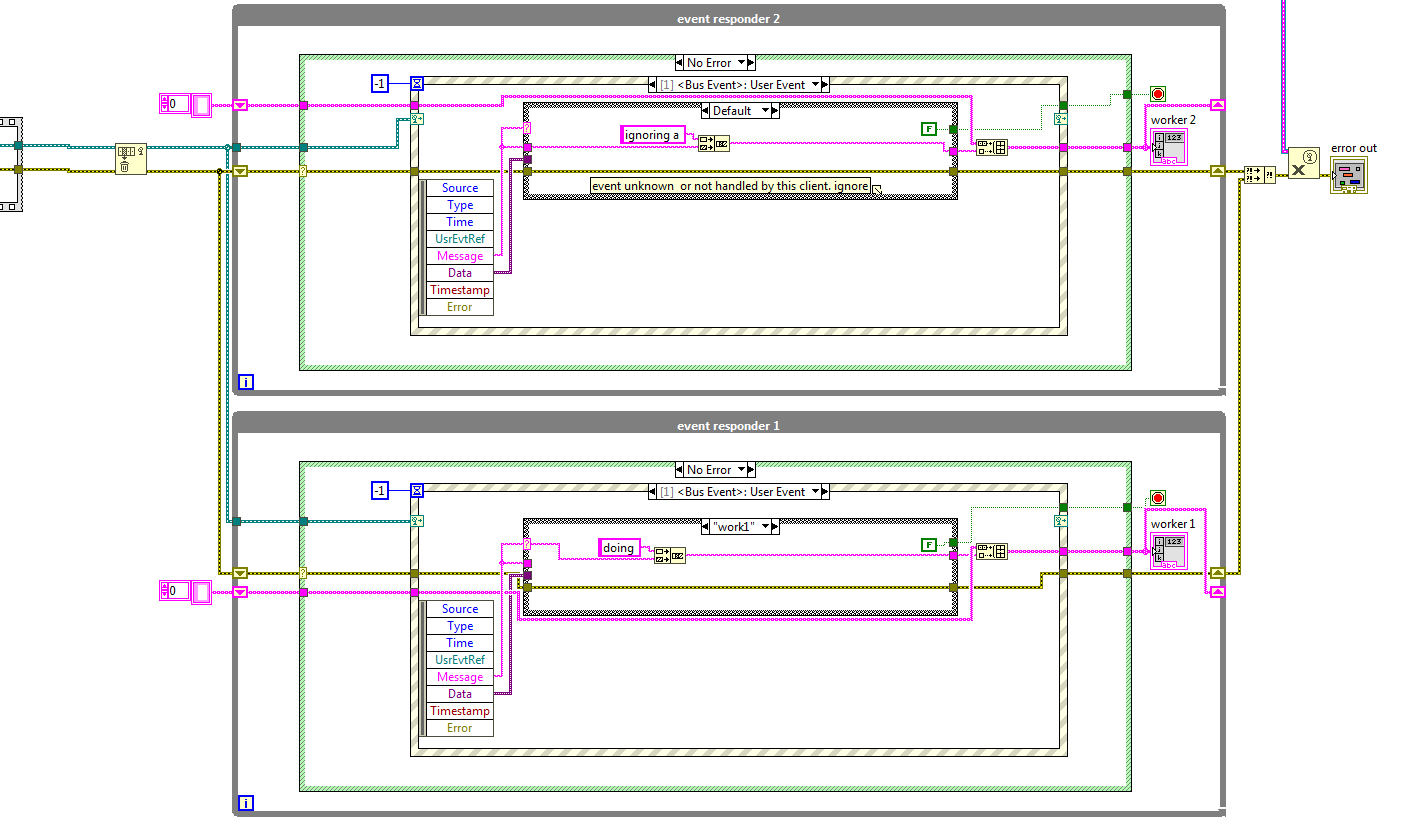

Event processing loops, one handles one task, another the other. both handle exit:

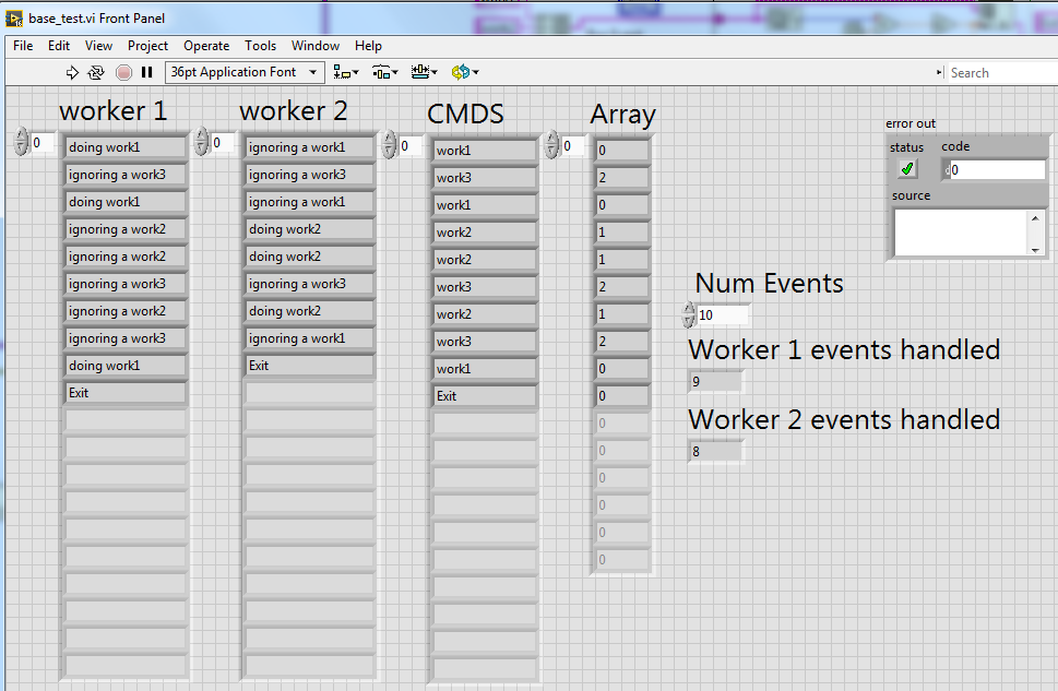

Front panel after an error run:

You cannot use the same registration.  You need a registration for the event at each place you want to "listen" for the event.
Think of each registration as a queue.  If you dequeue from the same queue in multiple loops, you do not know who will read which element.  Works the same for the registration.

It is probably also not a great idea to bury event structures inside case structures. Under error condition, the events will accumulate forever in the event queue because it cannot react due to dataflow, and once the error condition clears, you get the oldest event first, which might be stale by then, or not even valid because it happened during an error condition.
