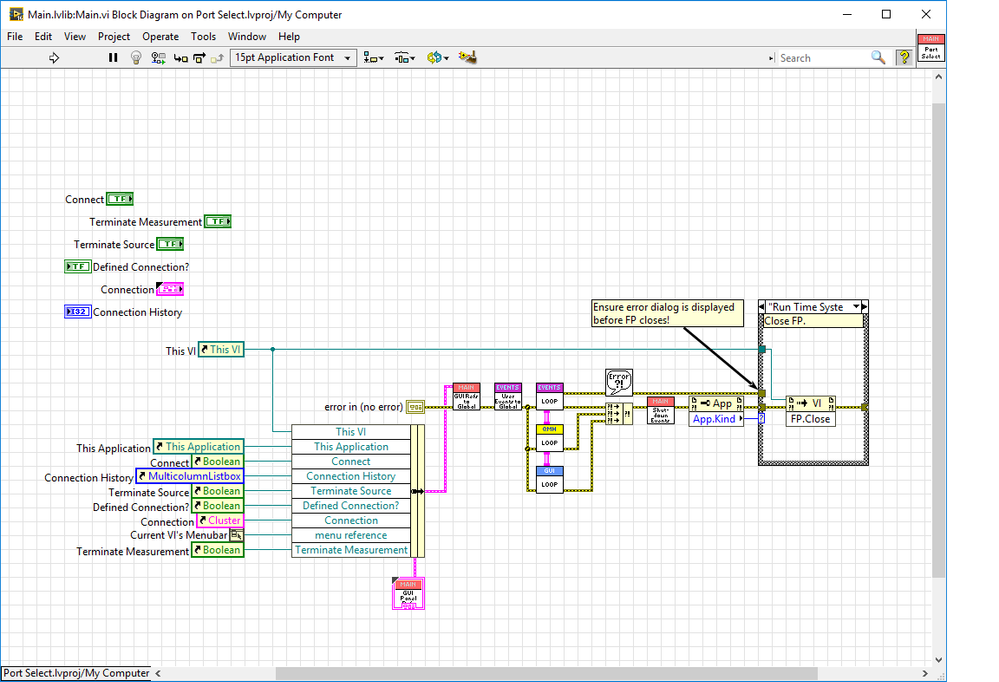

This is what my main.vi usually looks like:
But if I didn't encapsulate the loops into their own subVIs - and I don't think most people do that, really - I'd probably be pressed to fit it all into one screen.  I'd probably need to scroll vertically a little bit.  If you had a bunch of acquisition loops, it could get hairy.  In fact, it was only fairly recently that I started doing it, and it was all Ben's fault.  He posted something very similar in the Channels discussion, and once I saw how neatly it wrapped everything up, I couldn't go back.
Bill
CLD
(Mid-Level minion.)
Message 17 of 28
(1,603 Views)

I have started converting some of our applications to that model. The VI I'm referring to is over 10 years old now, and was written as I was learning LabVIEW. I see things every time I look at it that I should have done differently...
EDIT: And yes, one of the directives I was given in the beginning was to keep everything in one screen-space to minimize scrolling. Our former engineer's code had pages and pages of scrolling (vertically AND horizontally!!!); I guess it was fine for him because he was the only developer. But the boss told me to start from scratch and forbade me from using any existing spaghetti code.
