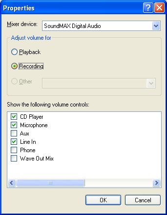

Hi!
This isn't a limitation of LabVIEW in any way. Most likely you will have to configure your sound card to accept input from your Line In input rather than the mic input. After that you can easily configure a stereo acquisition from your Line In on your sound card.
Assuming you are using the default Windows drivers for your sound card, follow these steps to change the sound input from Mic to Line In:
Open up the Sounds and Audio Devices application. You can find this in the Windows Control Panel (let me know if you aren't using Windows), and there's usually an item in the taskbar that looks like a little speaker.
Select the Options menu and select Properties. From this dialog make sure you select the Recording option rather than the default Playback, so that you can adjust levels and make selections for inputs rather than outputs.
Once you exit the dialog you will now see your input selections. You should check Line In. This will automatically deselect your Mic input. Now you can use the same device number in LabVIEW (default is 0) and use SI Config to configure a stereo sound acquisition that will be routed from your Line In input on your sound card.
Hope this helps!
