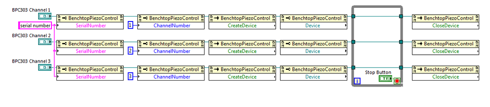

I have got it working with labview. To communicate with the BPC303 a few more steps were needed (see picture below). Also the serial number needs to be 7XXXXXX (also found on the machine) and then call the channels separately, rather than use a different s/n for each.
This post can be closed now.
