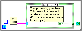

Hi Matt,
      Very clever tbob! (gonna remember that one...)
      Just out of curiosity, why is it burning CPU to poll queue?  I though the Dequeue timeout made it very efficient...

Dynamik,
The issue with Wait for Dequeue in my case is that I also need to look for other events in that thread.  So If I wait 5 seconds for dequeue I can not process other events.  With tbob's solution I only run the thread when information is in queue and I can process the other events quickly.  One further simplification is that I am not inverting the state when I use value (signaling) because any information written will generate an event.

thanks - should'a realized that's what you meant by "I have other events I am looking for"...
