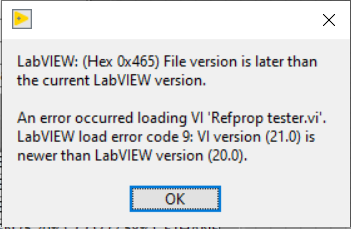

I tried Matlab script Node, and it looks easy, but now I have an issue in my VI attached here that the value of the variable (T) not passing to the node! When I initialized it, it works. How can fix this issue?
