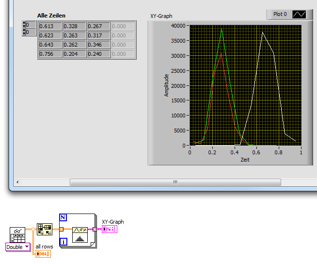

Hi Lexen,
no need to use ExpressVIs:
I used the simple Histogram function, there is an advanced one where you can provide more parameters. And I used LV2011, so the ReadSpreadsheetFile function looks different to the one in recent LabVIEW versions.
in the graph say C will the red color, G will be blue and D in green....
I don't know what CGD means, but changing plot properties should be easy enough!

Dear Dark Knight,
Omg your such a godsend, I have managed to work it out and did it as shown!
Thank you so much!
