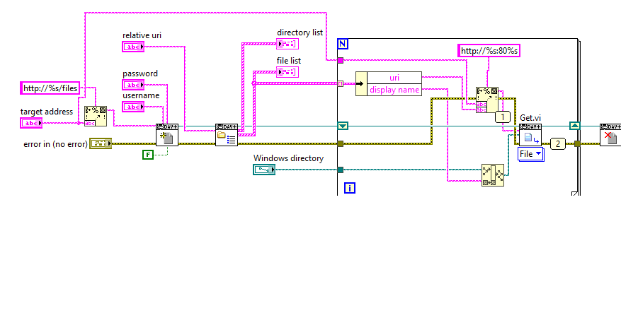

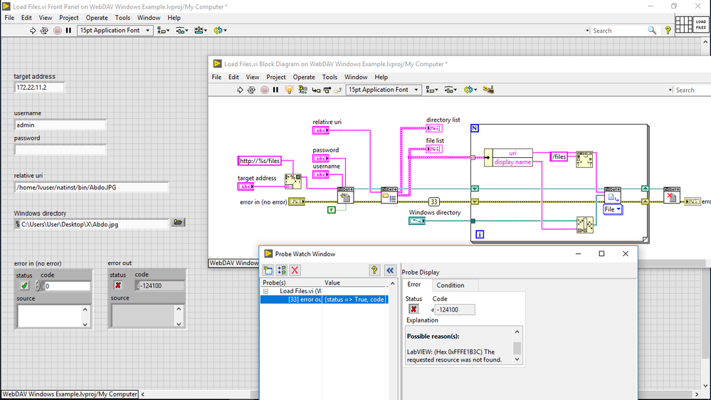

I have difficulty to transfer image file to real time target (myRIO) using WebDAV. I have follow this https://knowledge.ni.com/KnowledgeArticleDetails?id=kA00Z0000019PlESAU&l=en-MY steps to configure the setting. I have locate the "Abdo.JPG" file in the target (home/lvuser/natinst/bin/Abdo.JPG). Below is my VI and the error shown.
Error1.pngThe possible reasons states LabVIEW: (Hex 0xFFFE1B3C) The requested resource was not found. What I missing? Someone please help me Smiley Sad

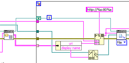

I struggled with the WebDAV GetFile VI myself recently.
In the end I created an absolute path for the input "relative uri" in the format:
http://IP-address:80/"uri-output from directory listing"
Here's a screenshot:
Regards, Jens

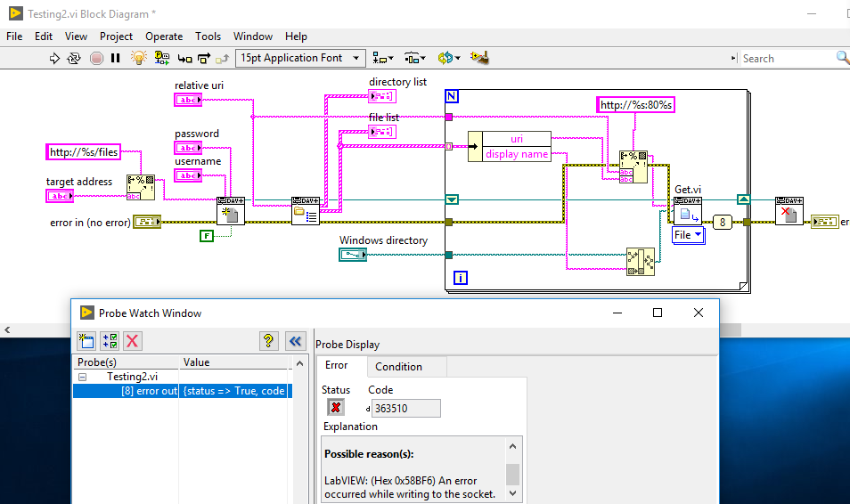

Thank you for your concern. I modify my code as shown below:
Error2.pngHowever, I get another error Smiley Indifferent. Can you show me what my mistake? Thank you

Update: I change the target address. Now, the error after the "Directory Listing" is solve. But, the same error (LabVIEW: (Hex 0xFFFE1B3C) The requested resource was not found.) occurs after the "Get File" vi.
