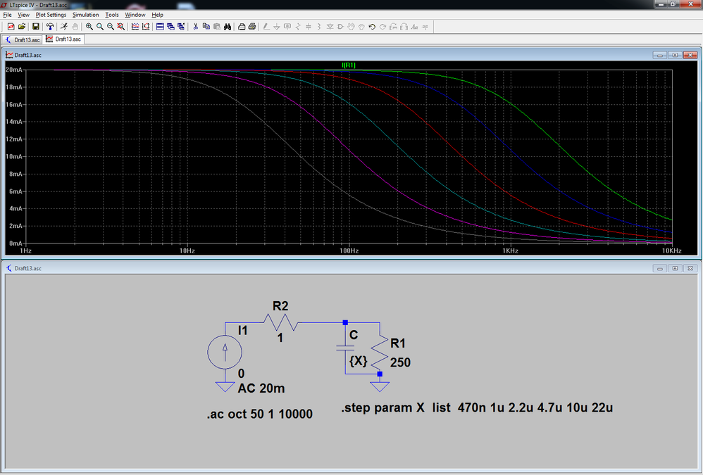

For a quick filter solution I made a graph for you
For common capacities the frequency response is shown. OK, the 470n is most rigth and the 22µ is most left 😉
And  ~36V rated caps are fine (assuming a 24V sensor supply)  10V should work but ....

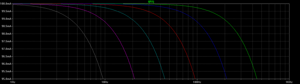

Small update:
The cap will result in an error, so here is a detail with different scaling (100mA is 100% )
With a 470nF cap you get an 1% error for frequencies >(~)200Hz
for the 22µF the 1% error is reached at ~4Hz
