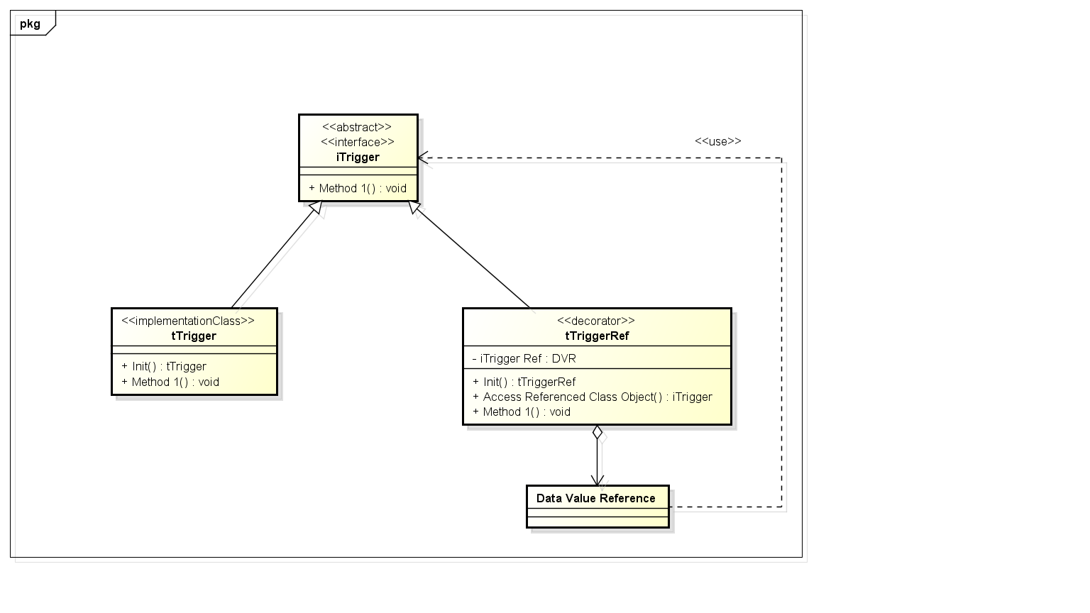

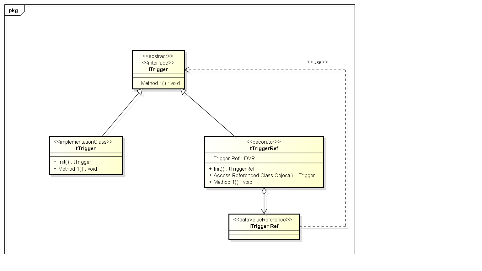

I had to do something similar to this in one of my applications, and as you have mentioned I made use of DVRs to do so.  I ended up with something like this (I believe it fits what the "gang of four" book would refer to as a decorator pattern).  It could be used to pass any class "by reference".
  1. An abstract interface class (iTrigger in my example) defines the methods required.
  2. A concrete class (tTrigger in my example) inherits from the interface class.
  3. An extra "decorator" class (tTriggerRef in my example) inherits from the abstract interface and also contains a data value reference to an abstract interface.

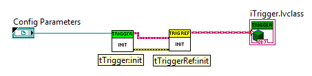

So creating an instance of this class would look something like this:

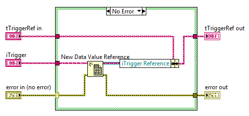

The tTrigger class contains the hardware implementation.  The tTriggerRef "decorates" it and its constructor looks something like this:

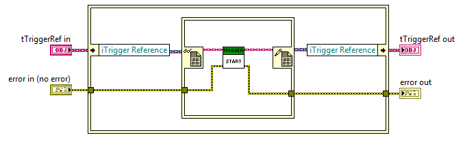

Each method on tTrigger Ref should simply read from the data value reference and make the appropriate iTrigger call:
If you have created a class like this, you may split the wire and each copy will only contain a data value reference back to the original class created by the initialization routine. The class is threadsafe in that only one thread can access the underlying data at a time.

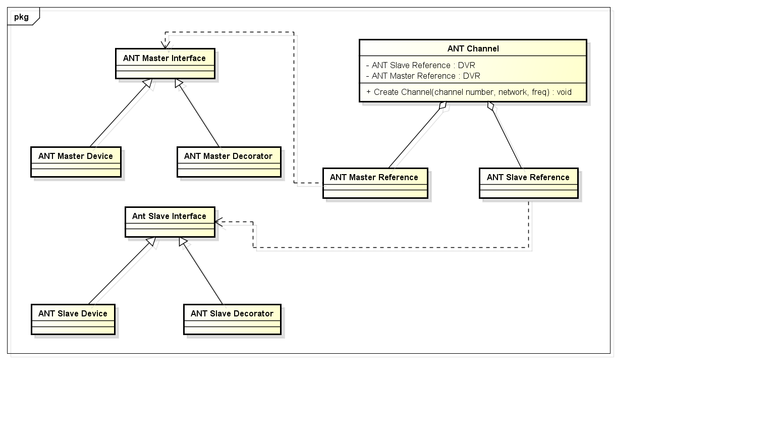

John,
Thanks for your reply.  If I'm understanding you correctly, your class diagram looks something like this:
Is that correct?

I guess I'm having trouble applying this to my situation... it appears that I don't need the decorator class.  Am I missing the point?

It's definitely not mandatory to use the decorator, you could just make the data inside the concrete class into DVRs and that class would behave how you want.
The decorator is a bit more flexible as it allows you to create the class as "by value" or "by reference" depending on the situation (though you might never need to use "by value").  Also it might end up being less work--in my case I actually had several concrete trigger types and implementing this with a decorator allowed me to change all of them at once into references without having to modify the existing classes at all.
EDIT:  I actually looked at your class diagram--you could certainly have the reference simply contain an interface but not inherit from it.   You wouldn't be able to use referneces and concrete classes interchangeably though (but maybe it's desirable to have a distinction between the two types in your case).
