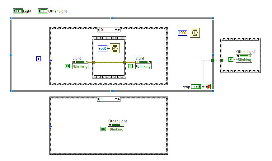

I'm not entirely sure I understand your requirements. But you can "flash" an LED indicator with the blinking property node.
(1,360 Views)

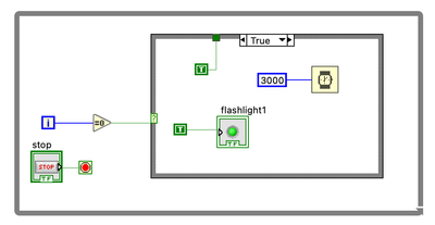

Thanks for your help. This is what I did and it worked for me. I didn't have to use a feedback node or the shift register.
Screenshot 2024-07-12 at 7.05.37 PM.pngScreenshot 2024-07-12 at 7.05.37 PM.png

This is still poor. We also cannot see most of your code (e.g what's in the other case or outside the cropped area.
You also need to define what you mean by "flash for 3 seconds. Blink n times over 3 seconds? Have it True for 3 seconds? Something else?)
Your indicator belongs outside the case structure. There should never be long waits, etc. all you probably need is a proper state machine that changes state based on elapsed time.
Please attach your VI and we'll fix it.
