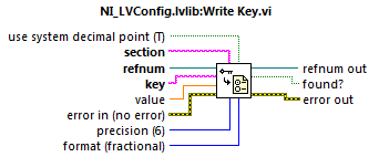

The Write Key function has a 'precision' input which will set the number of decimal places to save the DBL to (in your case, set this to 2):

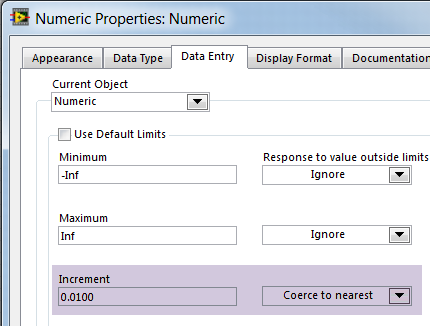

If you are using a numeric field, you can set the 'increment' property with 'coerce to nearest' to prevent them from entering more precision than is available:

Why don't you limit the numeric input to valid values? You can set a range and an increment to limit input values!

As mentioned, the easiest way is to set the display format of the control to 2 precision (to show the user), and a constant 2 to the precision input of the Write key (so it is infact written with 2 decimals).
