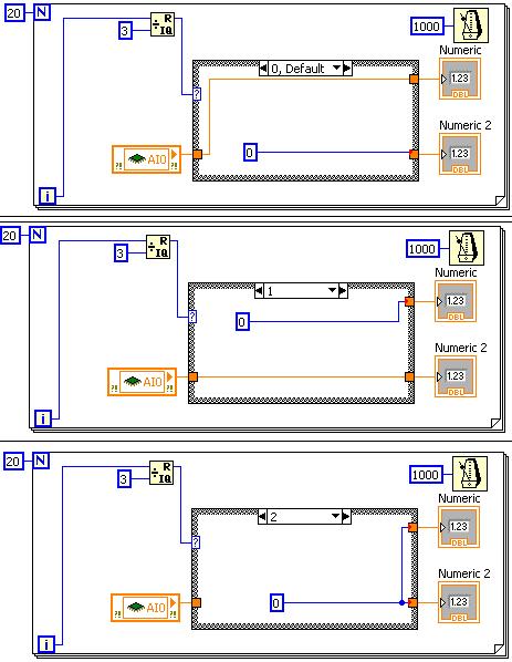

Here is a little i example i made to illustrate the question:
AI0 is an input that comes from NI9215 used with cRIO.
As u can see, it is used only in cases "0" and "1", but in case "2" i don't even need to have that measurement.
But if I would put AI0 into case "0", for example,  I won't be able to use in case "1" where I need it too.
So I wired it from outside, and it solves the problem, but again, measurement taken even when it not needed.
Now it is not really overloads the system, but in my head I have some maybe old school principle which says "don't use it if you don't need it".
So my question is if there some option to have "a copy" of AI0, so it can be wired inside the cases.
(3,215 Views)
It looks like a shared variable.  I don't recognize the symbol that is on it.
You should be able to make a copy of that very same variable and place it in the other cases.
