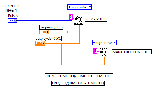

This is the current pulse train code:
CTR0 is phyiscally wired to a relay. CTR1 is physically wired to a Digital line on the same DAQ card.
This code above appears to simply syncronize the counters so that the digital line reads HIGH when the counter is HIGH..

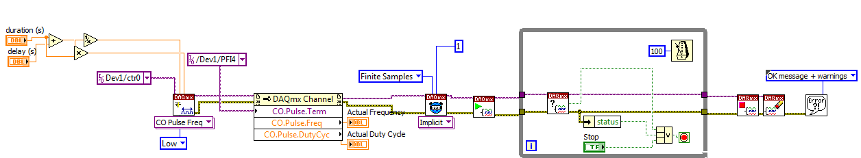

This is my code for the pulse train on CTR0:

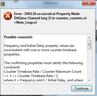

When I try values greater than 167 for the delay, I get the following error:
Error text:
Possible reason(s):
Frequency and Initial Delay property values are inconsistent with one or more counter timebase properties.
The conflicting properties must satisfy the following constraint:
Counter Timebase Rate / Counter Maximum Count <= X <= Counter Timebase Rate / 2
where X = Frequency and 1 / Initial Delay, and where Counter Timebase Rate = Master Timebase Rate / Counter Timebase Master Timebase Divisor or is inferred from the Counter Timebase Source selection.
Property: CO.Pulse.Freq
Corresponding Value: 5.917160e-3
Property: CO.Pulse.DutyCyc
Property: CO.Pulse.Freq.InitialDelay
Corresponding Value: 0.0
Property: CO.CtrTimebaseSrc
Corresponding Value: MasterTimebase
Property: CO.CtrTimebaseRate
Corresponding Value: 20.0e6
Property: CO.CtrTimebaseMasterTimebaseDiv
Corresponding Value: 1
Property: MasterTimebase.Rate
Possible Internal Timebase Rates: 20000000.0, 100000.0
Counter Maximum: 16777215
Channel Name: Dev1/ctr0
Task Name: _unnamedTask<218C>
The 'Counter Maximum' appears to be the issue.

Got some word from the lab, there was a miscommunication, they never used the code I was working off of for delays longer than 167 seconds!
Nevermind the error but if someone wants to answer the question regarding multiple counters, that'd be great..

You can use one counter as the trigger for another counter. You can also use one counter as the timebase for the other: the second counter will count ticks of the first counter (and those counts do not need to be evenly spaced, if you can find a way to vary it). I can't think of a way that two counters would switch back and forth.
To change the Master Timebase Divisor, try the DAQmx Task Property "Counter Timebase Master Timebase Divisor" found under Counter Output->General Properties->More. On your device you probably only have two options for the divisor: 1, or 200. Changing it to 200 will give you a clock that is 200 times slower, meaning your delay can be 200 times as long (but conversely, the shortest pulse you can generate will be 200 times as long).
