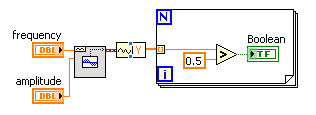

Yes I'm trying to use just one square wave signal to control them all.  From your reply the image below should work but it doesn't due to the fact that one is a boolean array and the other is just boolean.

A waveform contains an array of values. You must check each value and react to it accordingly:
