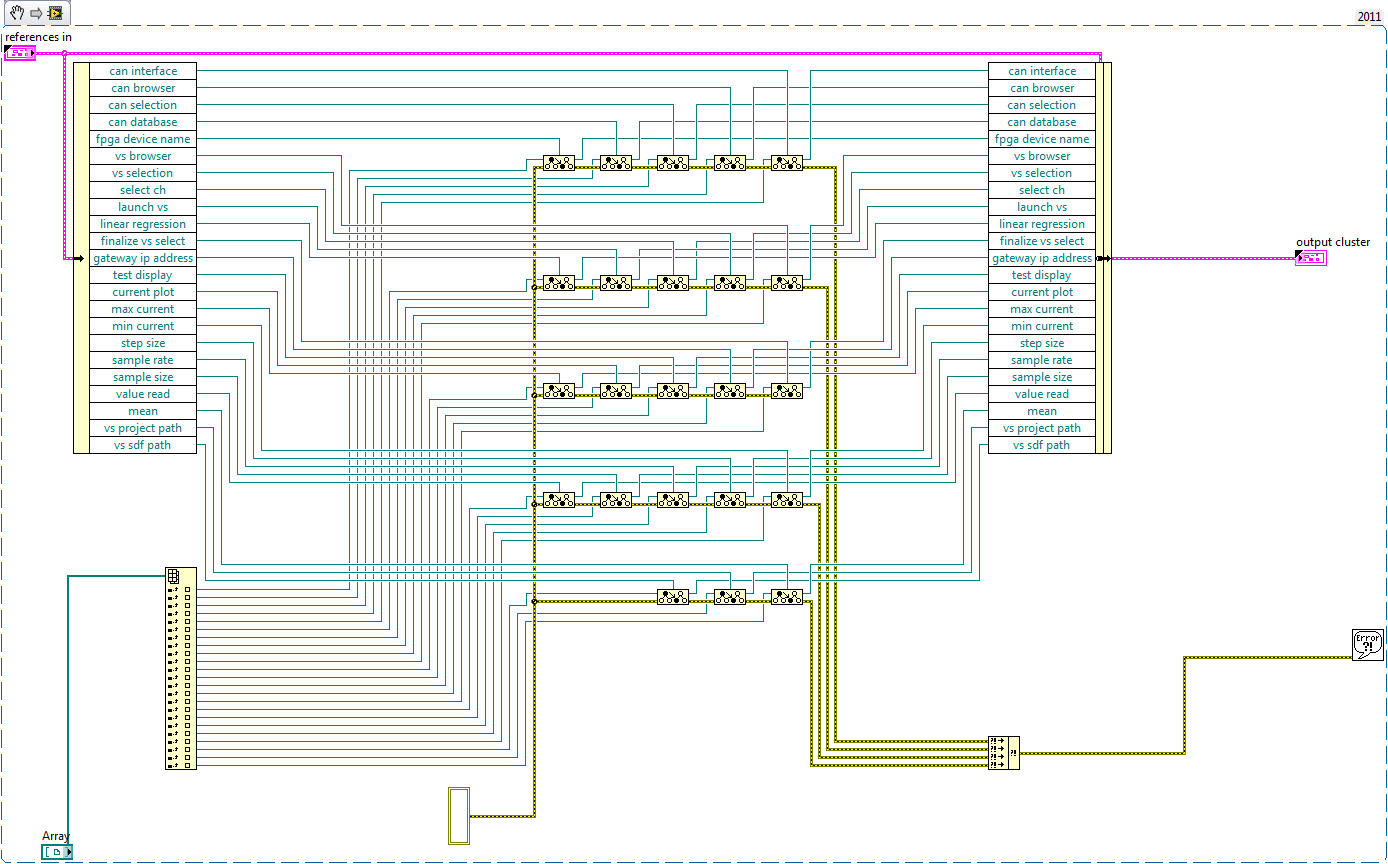

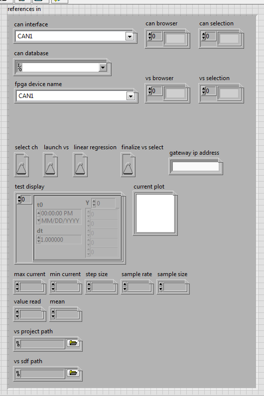

So I have a whole bunch of controls/indicators that I plan to use in my program.  I am going to have a seperate VI that loads all the default settings and user preferences during a "splash-type" screen before the user can use it.  So what I am trying to do is find an easy way to get all of my references organized and also make it easy to add more.
What I initially tried to do was make a cluster type def. with all the reference types that I plan to put on my front panel so far - then I referenced my Main.vi without opening the front panel and grabbed all the control references, but there are generic and I tried to typecast them to the strict classes that I want to use.  The snippet below shows what I tried.  I also included what my type def. is as well in case that might help. Some of them work and some of them don't.  Why will it not work? And what solutions are there available to do what I want?  Or something even better?

What I mean by "some work and some don't" is that when I use highlight execution some say "OK" and others give me error code 1057 - which is saying it cannot be cast to that type.  Why wouldn't it be able to cast to a more specific type regardless of what it is?
And those VI's are quite similar to some of the things I am trying to do.  At the very least I they may have helped me see something from a new angle and hopefully I can come up with something that works for me.
I guess some of my questions have less to do with my specific problem and more to do with how this "to more specific class" VI works and what it's proper use and limitations are.
