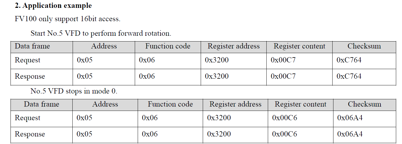

Also have a look at the attached pdf file for a Request frame forming example, page 4 describes the RTU and ASCII modes. ASCII is easier since it is human readable...
edit: you can also test using RTU modes, since there are many Request frame examples (like how to start motor go forward, etc.) at the very end of your user manual (VFD user manual-1.pdf)!

I put together a little test VI, based on the example from your manual. Could you test it? I might made mistakes with the hexa values... I used the NI modbus files from here: https://forums.ni.com/t5/Reference-Design-Content/LabVIEW-Modbus-API/ta-p/3524019
Unzip the content, and copy the corresponding files into the VI.lib and user.lib folder (like c:\Program Files (x86)\National Instruments\LabVIEW 2015\user.lib\ , etc.). Restart LabVIEW if needed.

I'll test it out. I can't seem to put in any letters for the registers (can't put in C7)
I'm gonna stop here and work on it tmrw. I appreciate all the help you have given me, Blokk. Thank you. Happy Thanksgiving.
Message 26 of 46
(1,845 Views)
C7 is not a letter, but a hexadecimal value. You can right click on the control, and change the view from decimal to hexadecimal. In this way easier to copy values from the manual. Anyway, happy holiday, and i still hope someone more experienced with Modbus (or in general) will jump in and clarify these things for us. I have some idea what to try, but I do not have the device to quick tests 🙂
