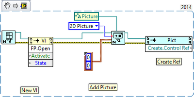

What is the VI Object Class for a 2D picture reference constant?  I would like to script the creation of the reference constant to the 2D picture object I created.
Using new VI object and the diagram reference I am not able to generate the reference like I would RT Mouse clicking on the Picture Terminal node -> Create -> Reference
I dont see any invoke options on terminal for create reference of change to reference.
(2,826 Views)
Accepted by topic author Carey3255
(2,820 Views)
Excellent.  Just what I needed!
