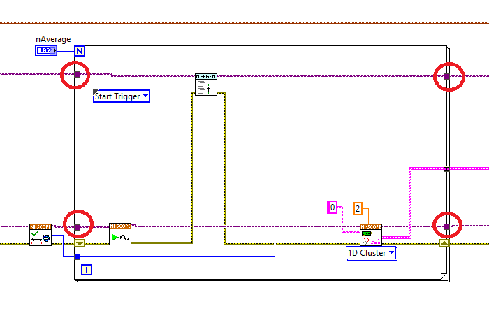

Why would you need a reference and why would you need to pass it into a FOR loop???
 you typically want to put references in shift registers across FOR loops.
Those are your words
Actor Framework
Message 11 of 13
(402 Views)
I was talking about the IO tasks here, i.e. the following tunnels should be shift registers.
I was using the term "references" generically: references (VI, control, etc.), DAQMx tasks, refnums for file IO, etc. etc.
(Anything that should retain the input value unchanged if the loop iterates zero times. A plain tunnel would output the default datatype in that case).
