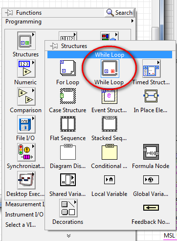

Hello
I recommend you to check the following link: Execution Structures in NI LabVIEW
Check these pictures also.
I hope this helps you.
Regards 😄
Mondoni
(3,632 Views)
