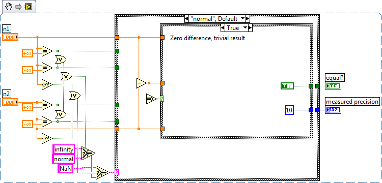

Getting warmer.  Hint number 2 - what are the outputs of the VI?
Message 12 of 18
(1,513 Views)
I'm tossing in the towel!
It must have something to do with the "measured Precision" output but I don't know what that value is supposed to mean.
Ben

For the record, the posted snippet is not <vi.lib>\Waveform\WDTOps.llb\Check for Equality.vi.  That would be this (for some strange reason, this VI is diagram locked on earlier version of LabVIEW).
The glaring error is shown on the inner frame.  The measured precision output, which is to how many digits the input numbers match, should be 15 (it is almost 16, log10(253)) for two equal doubles.  It is set to 10.
