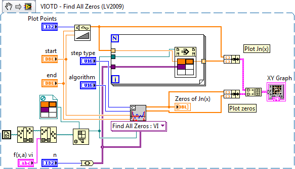

Now let's find some roots.  The key to any algorithm's success is preparation, in this case, bracketing the roots.  The better your initial bracketing, the better your results.  The Find All Zeros VI evaluates the function with small steps, looking for sign changes.  Each small change is then searched using the algorithm of choice to fine-tune the root.  I have posted an example which finds the roots of Bessel functions of integer order, a common problem.
As you can see, we combine Ramp, Call By Reference, as well as To Variant.  I use variant data to pass the order of the Bessel function to my VI which calculates Jn(x).  The For Loop is there to graph the function.  You can see from the graph that the routine works quite well, and is fairly fast for this simple function.
