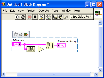

I can verify this works:
Then drag and drop example snippet into LabVIEW 2009:
Nice!  That's good to know!
Bill
