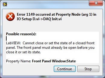

Almost, but not quite, I think.  This is what happened when I tried to use your technique on a VI that is intended to show its front panel only when there is an error.
I think the property node only works when the panel is already open.  Thoughts?
It should work if the vi is open, so from within it should work. Else you'll have to open a vi reference to yourself and open it that way.
