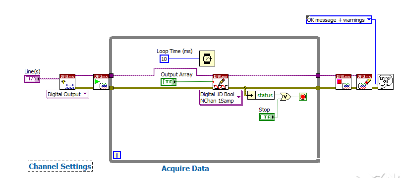

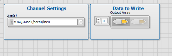

I have enclosed screen grabs of the VI which works for one solenoid, and the original VI (it wont let me save the modified VI properly).

Hi vdey
I hope you are doing great. Regarding your questions about the  digital outputs generation, I did my research using the same example of Digital -SW Ouput VI.
I did not change anything of the code except for some few changes.
Ok, first question
Using this VI example I am able to control the outputs and when I used one of the booleans controls I am able to turn on and off the different outputs of the modules.
Second question
If you want to create an automatic pattern with the outputs of the module, I think you can use a array with Booleans premade it by you combined with a state machine.
Third question.
Again, with a state machine you can use a delay function and instead of using a constant for the input you can create a control for it.
Fourth Question
Maybe you can try with a  Foor loop with a control attached to the N terminal to control the times you want to do this action.
Fifth Question
Try to copy the folder where are located these examples and save this new folder in a new location and try to work over this new copy.
I am attaching somes links that could be useful to you;
Sintax of multiple channels
https://knowledge.ni.com/KnowledgeArticleDetails?id=kA00Z000000P8qaSAC&l=en-US
Tutorial States Machines
https://www.ni.com/en/support/documentation/supplemental/16/simple-state-machine-template-documentat...
Warm Regards.
(5,237 Views)
