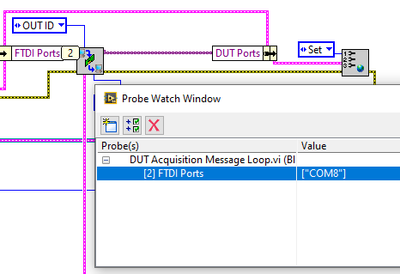

I've encountered an issue for which I can't seem to find a solution. I have a VI which builds debug commands based on a bunch of selectors. I had it working for a long time, but I recently added the option to build varying commands for communicating with multiple DUTs at once. Some commands for example require writing a string unique to each DUT, which ultimately requires a for loop. The loop should iterate for N cycles where N is the number of COM ports listed in the port array, and the unique strings are indexed on each iteration of the loop.

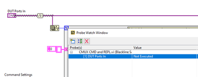

The VI executes just fine on its own (from its front panel), but when I call the VI from my higher level VI it seems to be bypassed without executing at all.
Essentially, when I probe the inputs of the problematic VI there is only the "not executed" message in the probe watch window. I then watch my main test interface (This would be the highest level VI in the structure) proceed to the next stage of the test, where I acquire data from a DAQ. At that point I can't proceed, because all of the setup I needed to be configured prior to testing was just skipped for no explicable reason.
Snapshot of my probe watch window from both perspectives. COM8 goes in... then nothing. I don't even see the front panel execute like it normally would. I tried recompiling the VI to no avail.

Interestingly, placing a breakpoint inside the problem VI "fixes" the issue. Of course I can't keep the breakpoint in there, and removing it allowed the problem to return.
Message 2 of 9
(1,796 Views)
Additionally, if I place a breakpoint on the Sub-VIs icon it also functions as expected after clicking the continue button. It's like the breakpoint is reminding the VI that this Sub-VI exists... Really scratching my head here.
