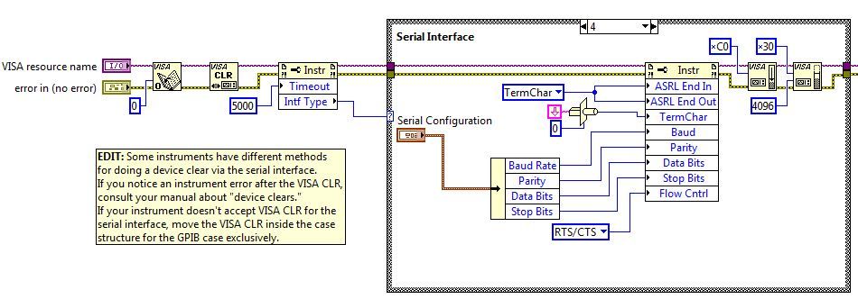

When I use the RS232 interface I can set a termination char for write and read operation's like that way:
This communication works perfectly with the termination char "line feed". In write and read operations. The visa write perfectly append the line feed ("\n") to every command.
With that I would only demonstrate how it should work.

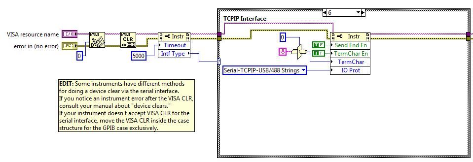

Now switching to the interface type TCPIP:
I can also set the property "Send End En" to True. This should normally append the 488.2 end of message terminator for TCPIP sessions.
I also choosed a "Serial-TCPIP-USB/488 Strings" IO Protocol for the instrument session.
But after an VISA write operation e. g. "*IDN?" the VSIA doesn't append the line feed (\n or HEX 0A). I used wireshark to trace the tcpip packets.
The line feed ("\n" or Hex 0A) is missing after the string.
I'm woundering about that behaviour, because 1. https://www.ni.com/en/support/documentation/supplemental/06/termination-characters-in-ni-visa.html desribes that "Both incoming and outgoing messages can have termination characters." Beacuse I'm using TCPIP Socket connection ("You need to tell VISA how messages are terminated only when using other VISA resource types (Serial Instr, USB Raw, and TCPIP Socket).") I configured the IO Prot for 488 commands.
But this doesn't work probably. What else should be configured?
Furthermore I found that the VISA Read STB and Trigger append the line feed. Why does the VISA Write doesn't make that?

I am currently facing the same problem.
But, I do not want to manually append the LF ('\n') character, since I want to reuse some old code.
Did you manage to understand what the problem was?? Did you find out which setting can produce the desired outcome?
