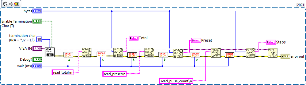

A sub-VI I wrote a while back has suddenly stopped working, giving the following error:
"Error -1073807339 occured at VISA read
VISA: (Hex 0xBFFF0015) Timeout expired before operation completed."
The sub-VI just sends a sequence of commands and reads back the answers from the instrument. I have made a new sub-VI containing the read/write sequence to do this, but also added in the intialise and close steps so that it runs as a standalone VI. Please find attached two versions of this, one simple and one which breaks the sequence up with timings (both produce the same error).
Interestingly, this error only occurs when run normally. When run in "highlight execution" mode, both VIs I have attached run perfectly and as quickly as "highlight execution" allows. In normal mode they take a lot longer, only to produce no outputs and throw out the error above. Furthermore, the error doesn't occur when the sub-VI is called by certain higher-level VIs, but does with others. As a standalone VI however the error is consistent.
Here is a quick list of things I have tried already and that didn't work:
1. Explicitly opening the session to the serial port
2. Flushing or not flushing the serial buffer
3. Increasing the wait time in the flat sequence
4. Using "bytes at port" to set the number of bytes to read
I have also seen and taken note of the presentation everyone recommends on the proper way to communicate over serial in LabVIEW from VI week 2020 to no avail.
I would also like to note that the device responds instantaneously to the commands when written via NI Max or the serial monitor for the instrument, so the problem is not instrument-side as far as I can tell. Also, the string constants need to be formatted in this way, and the device responds to other commands formatted in this way too. The issue with the reading of the response when not in "highlight execution" mode.
Any help that anyone could offer would be greatly appreciated.

Here, try using something like this to easily vary all the parameters and see why its failing.

Hi there,
As I mentioned in my original post, the instrument response time is extremely fast as demonstrated by its response to serial monitor and/or NI MAX. You press enter, the value is printed back immediately. There is no delay on the instrument-side. I will try altering the wait times again anyway to check.
The strings are in "\ codes display" so as far as I understand there is no additional termination character being appended, only what is shown.
The return is just a number which can be up to 10 digits or so. I just chose 32 because it's bigger than the number expected but I will try upping this.
I mentioned also in my original post that I have already seen the presentation you suggest. Nothing changed, that is the strangest part. I just carried on building the top-level VI but nothing to do with the serial communication, I was building in the communication with another device via its own provided software/LabVIEW package.
I will make the changes you suggest and let you know what I find. Thank you for your help!

Hi there,
The program works as long as the delay is above 934 ms. Anything less and I get the error. This is irrespective of what I set the VISA serial timeout to - I have set it anywhere from 10 s to 10 ms! This odd value is very consistent - with 934 ms delay the program runs perfectly, with 933 ms I get the timeout error!
I checked the return from the instrument is "x\n" as expected by changing the indicators to "\ codes display" format, so no issue there.
As far as I am aware, setting the termination character in the VISA serial initialise does not automatically append it to writes, it only means it looks for it in reads. Consistent with this, when I remove the "\n" from the write strings, I get no response from the instrument.
Sam
