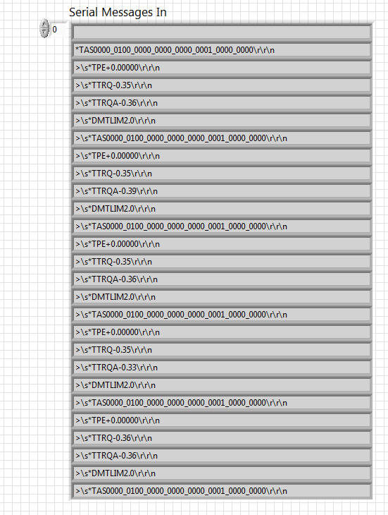

And just to preemt the calls to use \n instead of \r,  the code responds the same way.

To me, it looks like the second option (with \n as the termination character) is working fine? Each iteration of the loop (i.e. each VISA read) produces one array item which is a complete command string?
If you're getting timeout errors even with the second option, I'm not sure why it's waiting before returning the data, the VISA node should finish executing as soon as it sees the termination character (or 500 bytes).

Yes, the data is correct, but that's not the problem!
Please read the text of my previous post....

The problem with using a carriage return as your termination character is that you are getting two of them in a row, followed by a line feed character.
VISA read reads to the termination character,  you get data and the CR.
Next iteration, VISA reads to the termination character, you get the second CR.
Next iteration, VISA reads to the termination character, you get the line feed, data, and the first CR.
Just use linefeed as the termination character.  Then you'll get data, 2 CR's and the linefeed.  You can use Clean white space, to eliminate the extra CR's.
