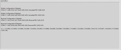

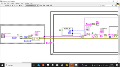

You can also see the screenshot of the program here with the two VISA reads. The first VISA read is ok i guess, but the problem is the second VISA read that happens in a loop, and every loop a certain amount of data comes, and the size of that is what I have hardcoded. The expected output is this:
So how can I do this without hard-coding the bytes to read in VISA read.

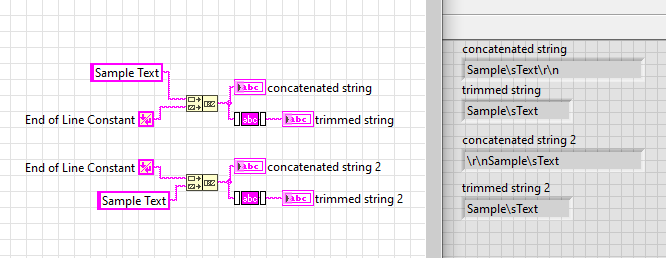

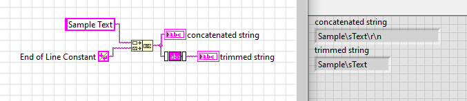

Well parsing is the computer programming term for analyzing text.
It's this simple
I turned on the "\' codes display" so you can see the CR+LF characters have been removed from the end of the string.
=== Engineer Ambiguously ===
