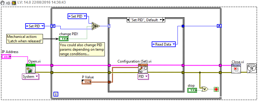

No, you still did not understand what I try to point out. You should change settings of the device only when needed, and NOT at every iteration! This does not make sense. For example, when you ramp up the temperature, you should ONLY change the PID parameters when you need to, not at EVERY iteration. Lets say, you start with some PID values at 1.4 Kelvin, then you keep these parameters and only doing reading values. When you reached 300 Kelvin, you can change the PID parameters again, but only firing ONCE the required VI. That is why you SHOULD use a proper State Machine with the required condition checks (elapsed time, temperature limits, etc...)!
Do not use the "Configuration(set) PID" VI repeatedly in a While loop! This is just silly if you do not want to change the PID parameters at EVERY iteration (and I do not see any real life scenario when one would do this)...

Ok, clear, you can programmatically change PID values, but you need to do so only at certain times when you reach some temperature range limits, yep? So when your temperature is inside a certain interval where you can use a single PID param set, you should NOT change these parameters at EVERY reading iteration. I imagine, at the device hardware level, changing PID parameters requires more time than a simple result read out...?
I do not have time to examine your hardware and how exactly the device can be addressed using the driver VIs, but here is just an example with manual PID change, it might give you idea how to use a State Machine...The manual boolean control ("Change PID!") can be replaced by a temperature limit check, so you ONLY fire the PID settings VI when needed, and NOT at every iteration. Fix up the code with missing VIs as needed...But do not forget, the only repeated action should be the simple "Read results" VI...
