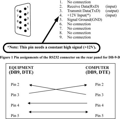

Hi domk,
I eventually got it working, after many hours of trying. 😉 It's been awhile, but I have tried to recollect what I did.
I made a special cable using an external 12 V power supply (the inexpensive kind that you can by at an electronics store to use for charging mobile phones and such). I connected it like this:
Equipment side        PC side
Pin 2                         Pin 3
Pin 3                         Pin 2
Pin 4                         "+" of the power supply
Pin 5                         Pin 5 and "-" of the power supply
Ground                      Ground
I got the advice to connect it exactly according to the schedule below, and that is also what finally worked. I think the problem was basically due to bad grounding.
You can also check this thread, which I started before the one you're reading. I got some help with the cable there.
As for the VI's, I have attached the read and write functions. As I remember, there was a good listing of the write and read commands were listed in the manual. Let me know if you need more help.
Thanks to everyone for the help with this, it is nice to know that it pays off to be persistent!
