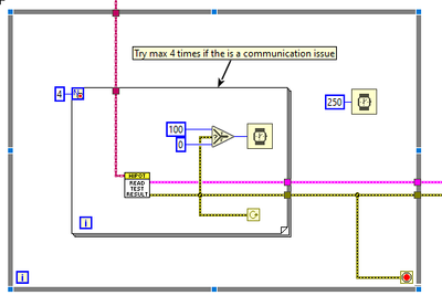

I have a VI which communicates with a USB instrument with VISA. First we send a "get status" message and wait for the response and the immediately send a "get error" message which returns a number and a string if the instrument is in an error. This is running in a while loop with a static wait of 250ms between the iterations. The VISA timeout is set to 500ms.
We are not worried too much about a timeout, we said if there is a timeout then repeat the operation max 3 time or until no timeout like below. Before say that this implementation makes no sense pls note that this is simplified just to show how the retry mechanism is implemented:
Still from time to time I get an error message "-1073807339,"Message":"VISA: (Hex 0xBFFF0015) Timeout expired before operation completed."
There are no concurrent communication to the instruments. The communication is implemented like this, the wait for response is always set to true:
Any ideas what could cause a timeout on the instrument? I'm quite lost, because the code is very simple and there are plenty of time between the messages.

Sorry for getting back pretty late on the subject there we other - non sw related - issues which had to be solved by our customer.
I modified the code per the suggestions. The only exception is that I kept using the visa flush before writing anything (see the snippet).
As mentioned before if the operation fails I repeat the it couple times before we say that we really have a problem.
It was not mentioned before but I use this VI to communicate with a GPT-9803 HIPOT tester instrument via USB. During the test we ramp up the voltage to couple kV (DC), then keep it steady for couple sec and finish the test. The instrument will respond to our query with a string indicating the current voltage, the current test time, a test in progress flag and a Pass/Fail flag. The instrument controls this porcess on its own, so losing the connection doesnt mean it will not shut the test down properly.
