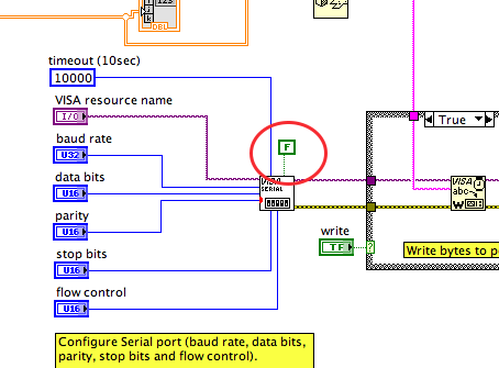

All you have to do is to connect a FALSE boolean to VISA configure connector that says "Enable Termination Char (T)", as shown in the attached image.

Hii BTC
first thank u for your answer but  i have enabled thermination Char but i see the same error again...

@Stockholm822 wrote:
Hii BTC
We told you to DISABLE the termination character.  Did you do any other debugging like looking at the strings that were written and read by the VISA functions?
