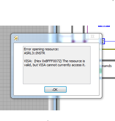

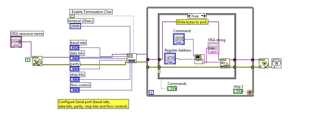

This is an analog front end AFE4403 to which I am trying to communicate by invoking its registers and commands. The communication randomly stops responding . I suspect that there is an issue with the way I am closing the session.Capture4.PNG
I am trying to verify the serial port sessions using realterm too, but its not helping much!

Accepted by topic author mysticdust
The error will occur when you have another program using the same port.
The image does not help much since the important stuff is inside the subVI.

I recommend putting a wait inside inside the while loop that writes to your device (or even better, use an event structure).
