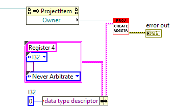

I found this VI that seems to do the trick: [LabVIEW 20xx]\vi.lib\FlexRIO\ProjectCreator\ProjectCreatorClass\Create Register.vi
Pass in the reference of the ProjectItem you want to own the Register, and it has a configuration cluster for setting the name, data type, etc. When I ran this code a Register was successfully created in the project.

Awesome.  I was able to use that, normal scripting and then \vi.lib\rvi\ClientSDK\Core\Script\Memory\XNode\Public\nirviXnMemory_Open.vi and those VIs to change the register read\write nodes and I think I got it all working.  Thanks again
