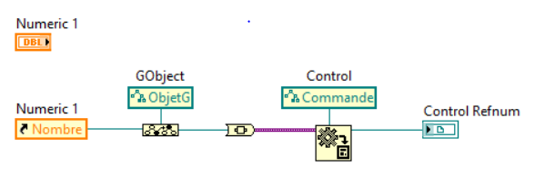

I noticed the "Variant to Data" function does not work as one could expect when casting VI server refnums.
Indeed, if I have a refnum of a specific class (e.g. Numeric) that I upcast to a generic class (e.g. GObject), then feed it to the function to cast it back to a lower class (e.g. Control), it simply throws an error...
Is it an expected behaviour ? I always thought "Variant to Data" just used the same behaviour as "To More Specific Class" / "To More Generic Class" when dealing with VI server refnums.
The upcasting however works fine...
The reason I am not using these 2 last VIs is because the input data I want to cast can be of any complexity (e.g. clusters that contain refnums AND non-refnum data), and the refnums may have been previously upcast.

The error is because a GObject Ref (your input to Variant to Data) is not a Control Ref.
Do it like this:

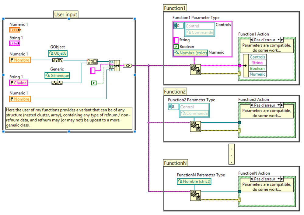

Here is a better example to illustrate my needs :
Function1 will always fail as "Variant To Data" cannot downcast the refnums, even if the actual data type of the passed value DOES match.

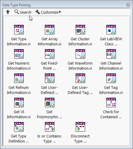

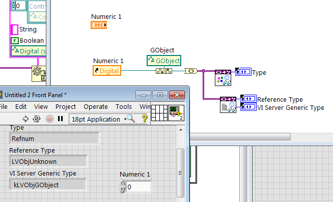

Look at the Data Type Parsing Palette for inspiration.
Here is a simple way to find the kind of reference, it's generic because you made it generic.
You will need to write something to handle all of the possible cases for your cluster.

It seems to me that you should fix the "User Input" part.  Your "Function 1" handler is expecting a cluster containing an array of control references,
but your "User Input" is sending an array of generic references.  If "Function 1" can only handle an array of control references, you should only send it an array of control references.  If you want to send it an array of generic references, you should make the "Function 1" be able to handle generic references.  You're putting a square peg inside a cylinder, trying to pound the cylinder into a square hole, then complaining that it doesn't fit.

You should be making a cluster of control references (preferably typedef'd) and not an array.  That way, you can access each control ref directly, instead of going through such convoluted code.
