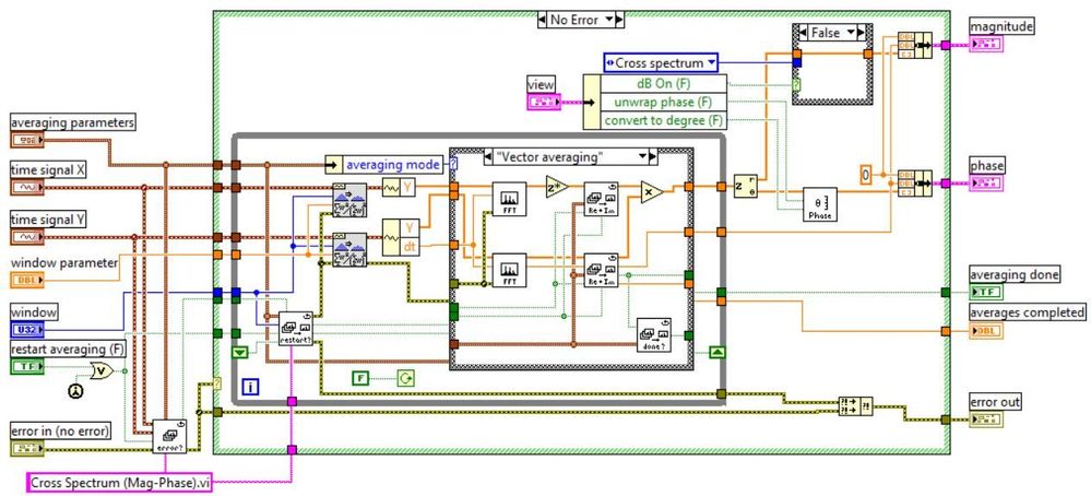

I am working on a project where I want to perform two-channel cross-correlation spectra.
for the calculation of two-channel cross-correlation, I am using cross spectrum vi (attached image).
The inside structure of cross-spectrum vi is showing in the image below.
But I do not understand the vector averaging process of the vi. Is this correct process to do vector averaging?
Can anyone help me to understand this vector averaging process?
for performing cross-correlation spectra of two-channel data, we have to follow these steps
first, performing FFT on both channels of the acquired data
Taking the complex conjugate of one of the FFT's.
Vector multiply the FFT and the complex conjugate FFT
Vector Accumulate the sum of the Vector Multiply step above
Repeat above for as many averages as are needed
At the end of the vector averaging, Dividing the sum of the vector averages by the number of Cross-Correlations.

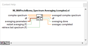

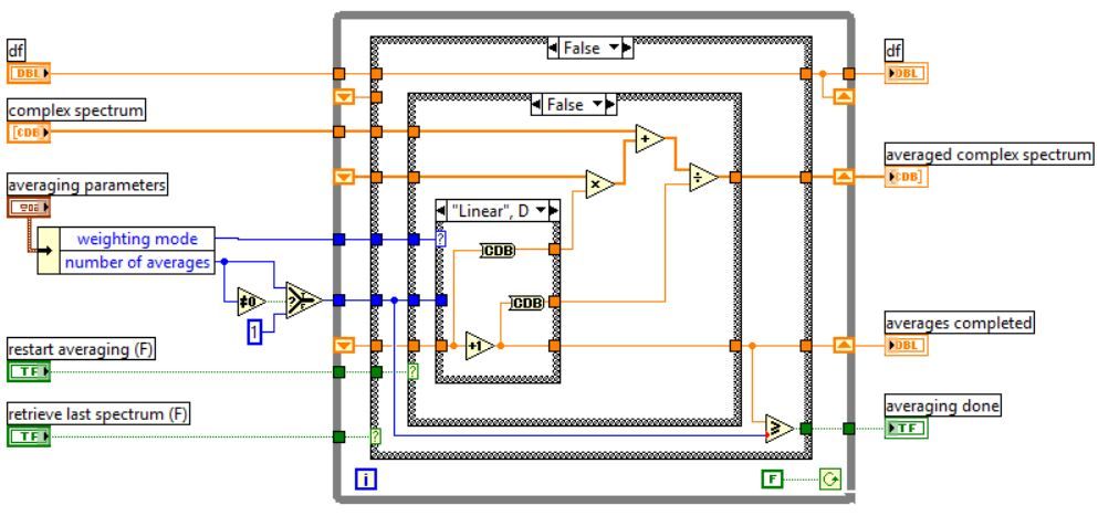

I am also curious about what is the inside structure of the complex spectrum averaging vi.spectrum averaging.png
which is shown in the attached image below. I have mimicked this spectrum averaging vi (in the attached file). When I run this VI for the averaging of an array of data, I don't get the average data from the output. Please check the attached LabView file and tell me what I am doing wrong on the spectrum averaging vi.  complex spectrum averaging .png

If you search on the Web for Averaging Cross Spectrum, you can find a note from NI that explains (?) the various averaging methods.
