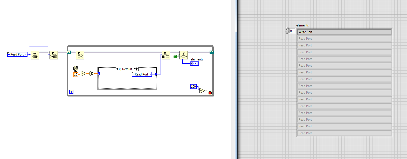

Is there a simple way to view the 'historical' elements of a queue? I'm using a producer/consumer loop which bascially operates like the example below (illustration purposes only):
I want to view all of the elements of the queue that have been 'de-queued' over the course of the VI's execution. At the moment I can only see the current queue status.
I imagine the simplest way would be to build an array based on the de-queued elements at the start but I can't seem to work a way of doing it.
The example above just loads an enum into the queue based on a random number between 1 and 10. Each case return a different enum and dumps it into the queue.

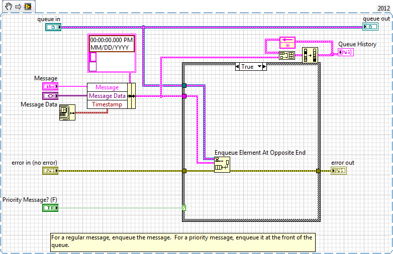

a simple change to Message Queue.LVlib: Enqueue Message.vi
Its not perfect (elements are in timestamp order but may be processed differently) but it should give you some ideas
