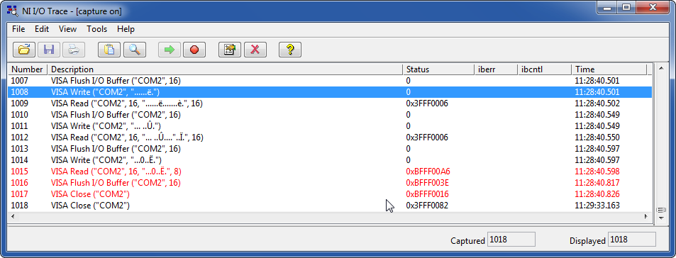

While developing my LabVIEW application I encounter the following problem:
If I call the VISA Close I occasionally have the problem that the call won't return. Below are screenshots from NI-IO Trace.
As visible on the 2nd screenshot the "output" tab is missing. Also a start time is filled-in but the finish and call duration are missing (as in the 3rd image)
The hardware setup is a FTDI FT232RL connected via USB. From this a board based on a RS485 is connected.
The drivers of the FTDI chip are version 2.8.30.0 (latest VCP drivers on FTDI web-site and Microsoft update)
Edit:
As long as the VISA close won't return my program hangs so it is not possible to quit in any orderly fashion (except for a reboot)
Do you have any suggestions where I can start debugging this problem?

Your VISA read calls return a status indicating that there might still be characters left in the transfer buffer.
Are you sure that the buffer doesnt encounter an overflow?
I understand that this hang does not occur every time. Correct?
What makes situations where the hang occurs "unique" (e.g. long duration of communication, large amount of command/data transfer, ...)
What happens during the hang if you unplug the USB cable?
Does VISA report a correct error if you unplug the cable during a "normal" communication?
Norbert

It's correct that the Labview *thinks* that there are characters left in the buffer. I ask for 16 and I get 16. So since there is no timeout and I don't check if there are *only* 16 characters in the buffer I get this warning. (my read code)
Visa read
It is correct that the hang doesn't occur every time. It was (I'll get back to that) about every 3/4 closures. After that a reboot is required.
So there is nothing unique to it.
If I unplug the cable nothing happens (no change, the hang remains)

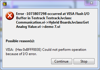

A unplug during normal communication I just tested and below are the results:
So all seems normal.
However I have to admit that there were some changes to my set-up.
Since I didn't have this problem before I decided to uninstall all virtual com port drivers and also remove their presence in the system.
After this no hangs happened *so far*.
If it's useful I can do a write of my process (the only question is where?)

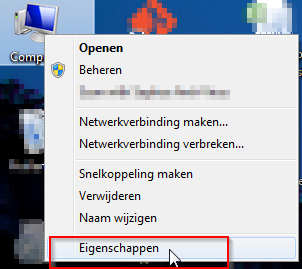

1st add the option to show all disconnected devices by opening the system Environment Variables:
right mouse button on "my computer" and select properties.

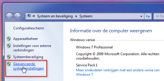

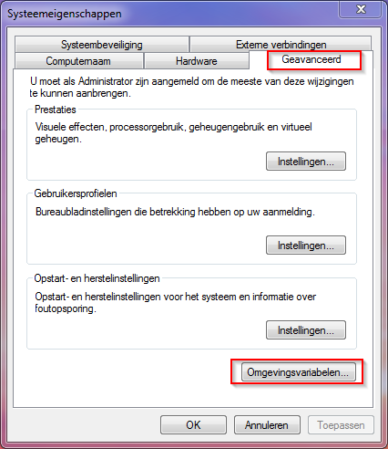

In the system property select "Advanced system settings"
If requested accept the UAC prompt.
Select the advanced tab, Select the Environment Variables.

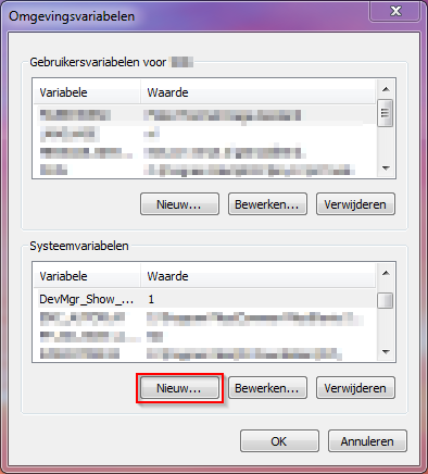

In the Environment Variables window select the lower New button

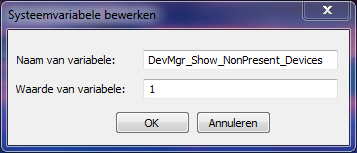

Add the variable "DevMgr_Show_NonPresent_Devices" (without quotes) and a value of 1.

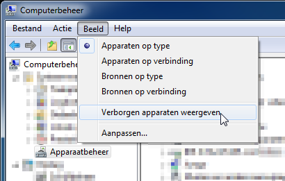

In the device manager select view and select "Show Hidden Devices"

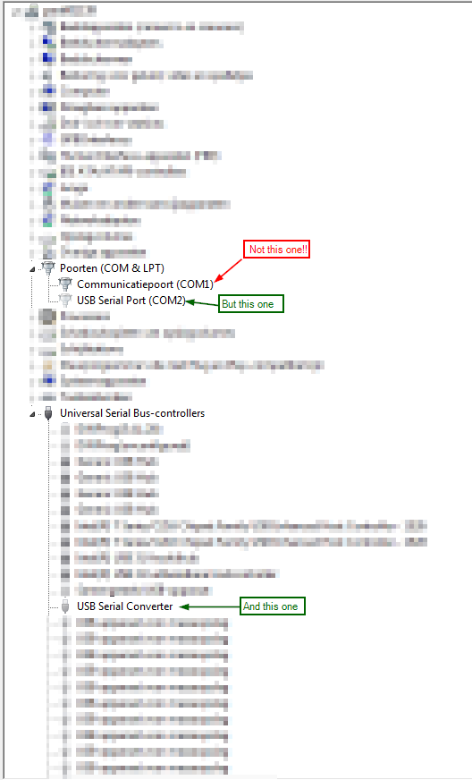

The list will now get extra long since all devices that where ever connected to your computer will show up.
For the next step disconnect all (USB) serial ports from your computer.
All serial ports that where connected will now show up under "Ports (COM & LPT)" and under "Universal Serial Bus Controllers"

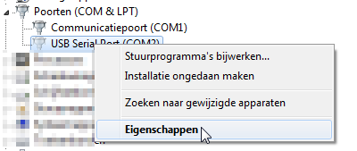

For every "USB Serial Port (COMxx)" port and "USB Serial Converter" that is semi-transparent (disconnected) do the following steps:

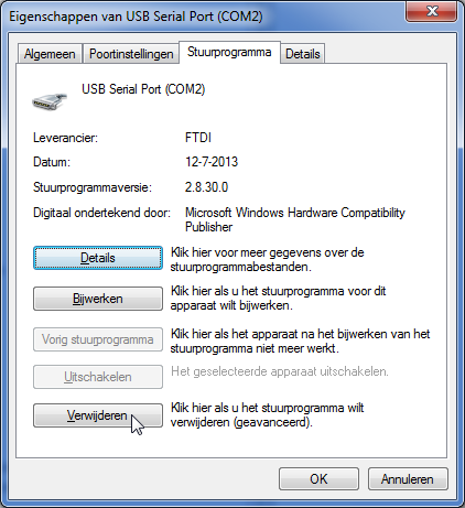

Right-mouse button on the port or converter and select property's
The general tab should give a code 45 that the device is not connected.
Select the "Driver" tab next and select "Remove"

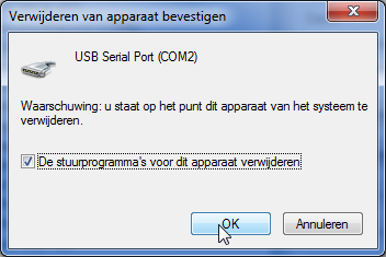

In the confirmation dialog select the checkbox (if present) and select "OK"
Once this is done for all "USB Serial Port (COMxx)" ports and "USB Serial Converter" devices you should be good.
