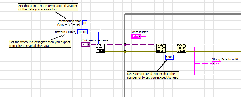

Here are some tips for serial reads. This method the serial read will read until it reaches the termination character or times out. You of course will have to deal with the timeout errors properly if you don't want the program to stop on error.

One reason for the time out seems to be (when running the Test serial exe) that the visa write does not seem to be sending the "?" over to the main vi so that the main vi would send the data sting.  Any idea why this would not work?

I am getting data now but, it seems to be hit or miss.  Sometimes it sends an empty or partial string and seems to be running slower that 1Hz as set by the delay.  Also, if I did not change the values of the term character or the time out would not be the same as using the defaults? Are they not active as default without wiring a constant to them.
The defaults will be used if you do not wire them. Also I forgot to check and see what type of flow control you are using. If you are leaving that terminal unwired it will default to NONE.
Wire it to set a reasonable form of flow control. I have found that XON/XOFF is only good up to 9600 baud, anything over that needs a hardware flow control like RTS/CTS to be reliable. Note that hardware flow control requires the hardware lines to be present in your serial cable. Many cheap serial cables only have Rx/Tx and ground.
