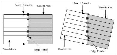

I've not used Rake, so I opened its Help to see how it worked, and found this:
do know how to create a rotated ROI, so my guess is that to Rake at, say, 30°, you put down an ROI, rotate the ROI by 30°, then use that rotated ROI with the Rake function.

I already tried setting a rotated ROI as input, yet the "search lines" output still has a constant value for y (height). But you got it right: Thats why I want to rotate the reference picture - if Im not able to rotate the Rake tool.
The picture in the Help implies that its possible:
Message 6 of 9
(5,136 Views)
Ok. So since I cant find a soloution for my initial problem, I'll keep this thread open.
I found a way to rotate the Rake tool. Actually its excatly how you said, the rotated ROI does also rotate the search lines, I just didn't know that the value of rotation of a rotated rectangle has to be 1000 per degree. So a value 45 would actually be 0,045 deg, which explains my confusion.
Thanks!
