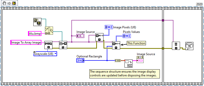

I am using the function Image to Array in the snippet below. (It is just a modified example) For the image to array function, you can include a bounding rectangle that will extract the pixel values.
When you extract the data, the data includes pixels starting from xLeft & yTop to xRight -1 & yBottom - 1. Is there a reason one boundary is included and the other boundary is excluded. For consistency, I would think both boundaries would be either included or excluded. (I know I can modify the rectangle to include boundaries or exclude, I just want to know the reason why it is defined like this. Maybe so the area of the rectangle is consistent with the boundaries, that is, length*width; that is my best guess, otherwise I really don't know.)

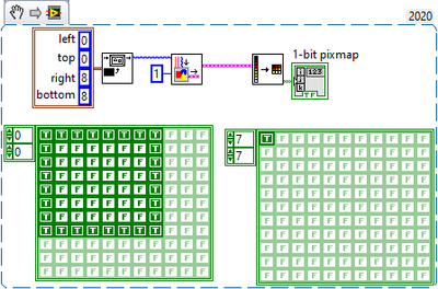

It is not limited to the ROI coords, this is the general behavior of the LV drawing functions.  For example:
It chaps my hide quite a few times.  When I go to draw two rectangles (0,0,a,b) and (a,0,2a,b) the shared line is always double thickness until I make the adjustment.

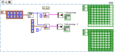

Plus, let's draw the same rectangle using multiple line segments
If you let Picture to Pixmap.vi automatically determine the picture bounds, it clips the right and lower edges.  If you manually specify the bounds, you get what I would expect.  Sigh.
This mess has been around since the dawn of time and probably falls under the 'somebody out there is relying on this behavior' umbrella.  I wouldn't hold my breath for a fix.

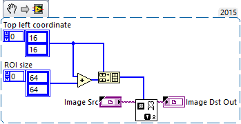

It saves the user from adding all those pesky decrement operators when using coordinates. You want a region of A by B pixels with top left coordinate X,Y? Then simply add A,B to X,Y and concatenate.
Working a lot with images I prefer it.
