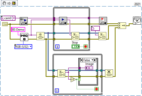

OK, here's a lesson on Debugging and Finding the Problem.
I think the issue you are having involves the Producer/Consumer Design Pattern.  So when Life gives you a Lemon, make Lemonade!
Write a tiny VI that does the following:
  • Configures a Camera for Grab.
  • Creates an RGB Image for the Camera.
  • Creates a Queue for the Image (for Producer/Consumer Pattern).
  • Grabs and Enqueues (in a While Loop) an Image, with a Stop Control to stop the Producer.
  • Closes the Camera, ending Camera processing.
  • Enqueues a Sentinel (an empty Image), ending the Consumer Queue processing.
  • In a parallel While Loop, dequeue an Image.
  • See if the "Image" is not a Number, Path, or Refnum
    • If it is, that's the Sentinel, so do nothing with the Image, and exit the Consumer Loop.
    • Otherwise, display the Image.
  • When the Consumer exits, Release the Queue.
  • Merge the three Error Lines and pass to the Simple Error Handler.
Please do these steps, and see if you get a VI with no errors.  If so, run it and see what it produces.  If you have a WebCam on your PC, use that as the Camera.  Here's what you should get (do keep those Error Lines straight, please] --

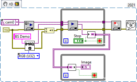

What I really wrote was a slightly simpler version of this routine that used Stream Channel Wires instead of Queues.  Here is the Channel Wire version of the same routine:
The "unfamiliar" item in the Producer Loop is a Stream Channel Writer, which "adapts" to whatever is wired into it and "streams it" (ignoring "boundaries" like the While Loops) until it finds a Channel Reader (the item in the lower While Loop).  The "Stop" Control is wired to not only the Producer's Stop Indicator but also to a "last element?" terminal that passes the "Stop" signal to the Consumer, where it is used to stop the Consumer (and simultaneously stop the use of the Stream Channel).  Simpler to visualize, and the "data" in the Stream always flows "in the logical direction".
Both these simple demos produce the same results.  Code one (or both!) of them up, test them, then find the corresponding logic in your code and "fix the problem".
