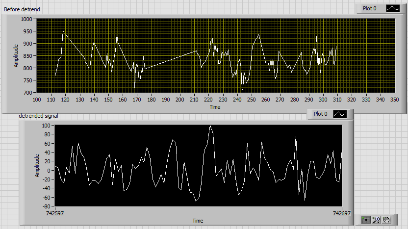

I am stumped trying to analyze an unevenly sampled signal (such as R-R intervals of an ECG signal, for those familiar)
Before applying "Unevenly Sampled Signal Spectrum" VI I want to detrend the signal and am trying to use "WA Detrend" VI for this purpose.
What I don't understand is how to apply this detrending VI to my unevenly sampled signal.
If I just feed it the array of values, then it mistakes them for evenly spaced values from what I can tell looking at the attached screenshot of the signal before detrend (with the correct spacing between points) and the detrending signal (where I can see the uneven spacing disappear):

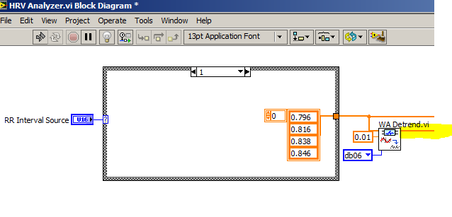

Interestingly, looking in an example in Labview's own Biomedical toolkit, I think they are making the same mistake detrending an unevenly spaced signal. Here is a screenshot of the example called "HRV Anayzer":
They are feeding the "WA Detrend" an unevenly sampled signal but nowhere does the VI know what the spaces between the points are. It therefore will produce a wrong result, to the best of my understanding.
LabView, are you sure you're not having a big bug here?
P
Nice catch!  Without looking at the rest on the cases I can only assume somebody missed a use case whipping up that example
