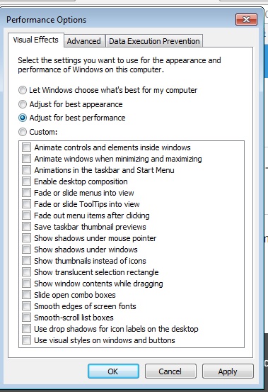

Accepted by crossrulz
Don't laugh,   but the solution was extremely simple,  remember the pauses mainly occured when moving, closing, opening the LabVIEW GUI.
It took over 3 weeks to figure this out:
Performance options,  Choose the "Adjust for Best Performance" option.     I can't believe this.
Windows 7 performance options
As to why I put my diagram background as dark as one of you posted,  it's because after programming over 20,000  hours of labview in 20 years time (many of those hours on CRT), my eyes are fried and I am not able to look at a white screen more than a few minutes without experiencing severe discomfort.  Maybe that blue LED light coming through has caused this. Don't know. Also can't handle fourescent lighting very well.
Thanks for all your comments,  Bradley

OH NO!
to be brutally late to the party-  you could have probably fixed the issue by simply disabling the AERO themes for Windows.
